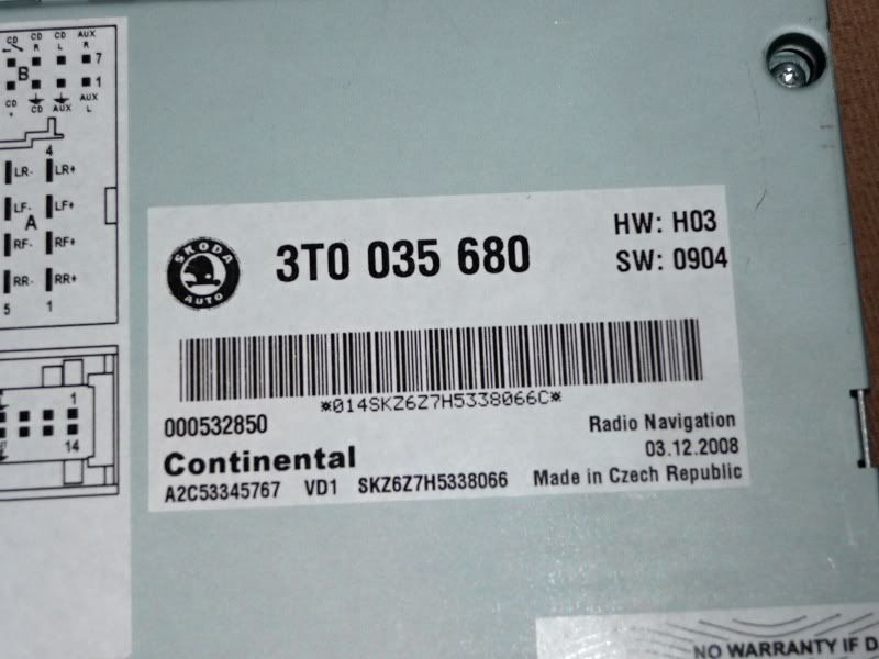

Hallo Kollegen, ich habe eine modifizierte firmware 2724 für OII 04-08 installiert, funktioniert immer noch ohne Probleme. Mein Navi:
3T0 035 680 A
HW: 02
Herstellungsdatum: 22.04.2008

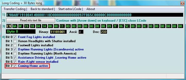

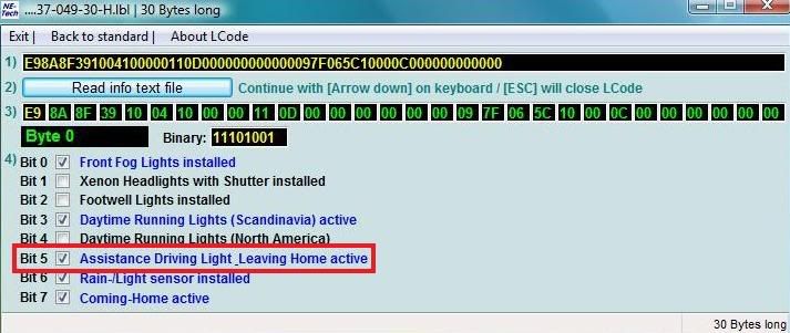

Vico: Of course. You need someone with VAG-COM.
And:
1) select Central electric-09
2) Long Coding-07
3) Open Lcode (Calculator for Long Code)
4) Select byte 0 and check bite 5. Picture
5) Select byte 0 and check bite 7. Picture
6) Do it!You can on maxidot after coding, selecet time (how long will the front headlights turned on - in seconds) for Comming and Leaving Home.
These functions will work only if the switch is in position headlights are turned on. If not, Coming home function is not active.

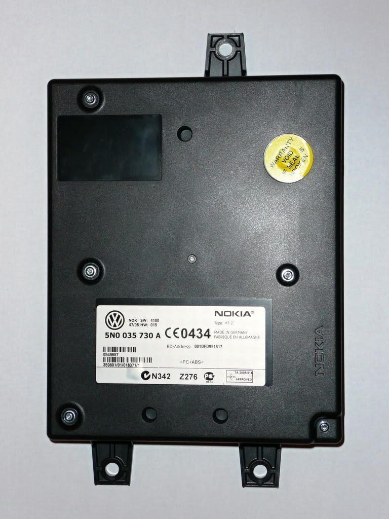

Here are any photo from montage Superb II connect microphone (with existing bluetooth handsfree Nokia Premuim)
If you have Nokia HF Premium, you can use the existing microphone.
MIC to Navi (MIC IN)
Navi (MIC OUT) to HF -

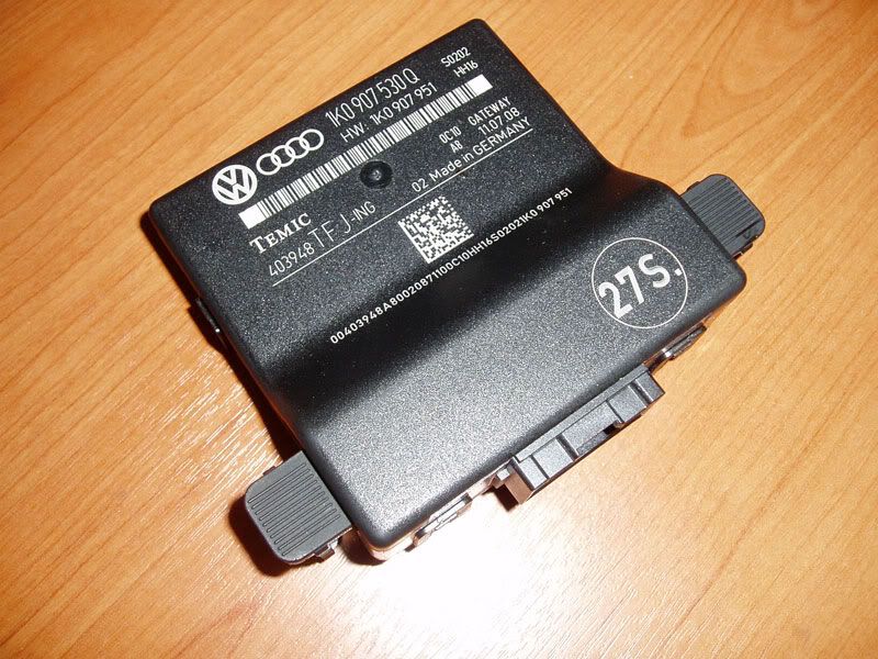

To magic62:
Ok, I have same part number 1K0 907 530 Q.
Now, my guide:
1) Use VAG-COM, save coding the existing gateway.
2) Disconnect negative pole on the battery.
3) Remove control lights, decorations and cover under the steering wheel.
4) Gateway is on the right of the steering rod.
5) Disconnect gateway, replace a new one.
6) Mount parts (teile).
7) Connect negative pole.
8. Select Gateway - 19 -> Coding - 07 use label 19-1K0907530-10byte.xpl (lbl) and open old coding in other Lcode.exe, recoding in conformity with old coding.
9) Do it!
10) That´s all.

Yes I had problems with the new firmware. As having a 2006 RS-TDI with a H-Gateway, I had problems with the battery.
Seems that there is a problem with the CAN-BUS idle. The system doesnt want to shut off the BUS.
I bought a Q rev Gateway and will change it as soon as it arrives.
Thanks again for your superb
support.Yes, problem is with old gateway! You must use new gateway, I have too gateway Q and Columbus works perfectly!

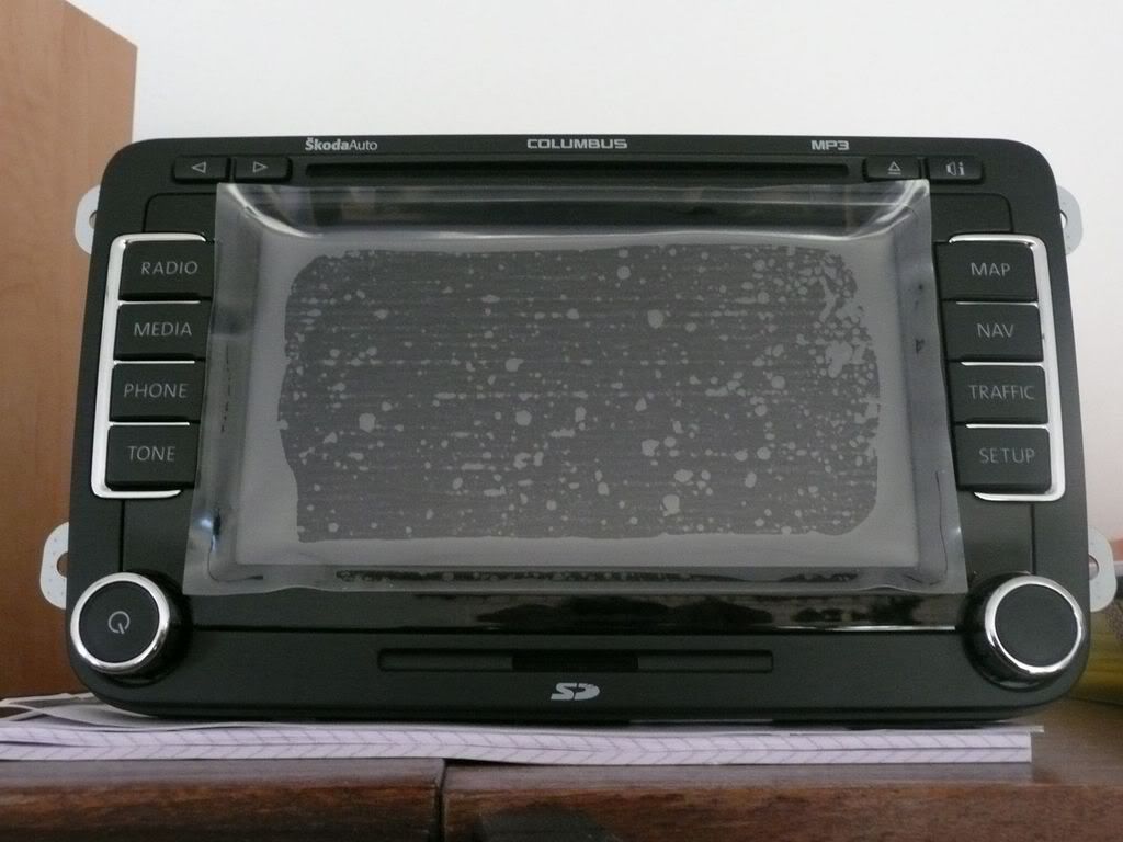

Erste, second, dritten fotos Columbus zu verkaufen!!
vierter, fünfter, sechster Foto von meinem Columbus ist das, was ich zur Zeit im Auto.

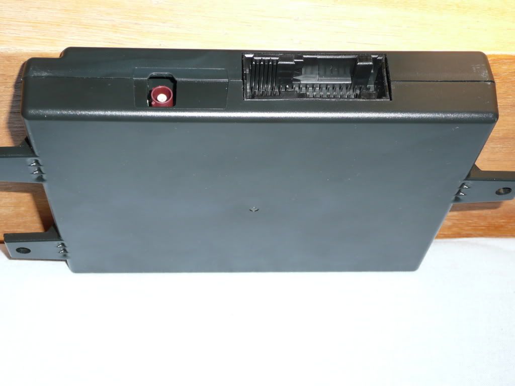

Ich verkaufe neu Handsfree III Premium NOKIA (UHV+rSAP).
Only unit 170€
With cables 210€

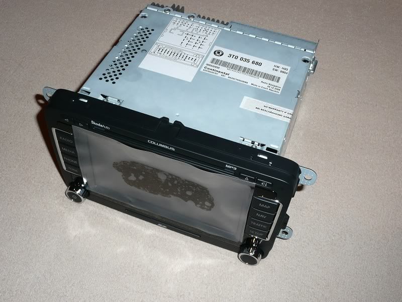

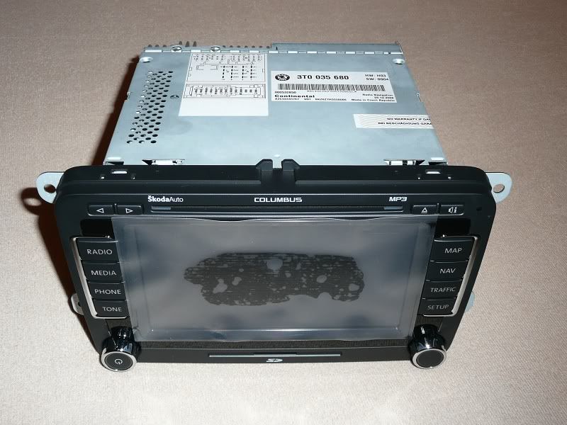

Hallo, verkaufen Columbus 3T0 neue für den neuen Superb und Octavia II.
Einschließlich maps East und West Europe V3. Und PIN code.Preis: 800€
